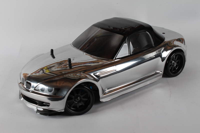

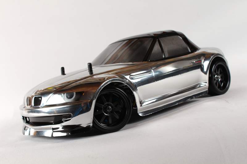

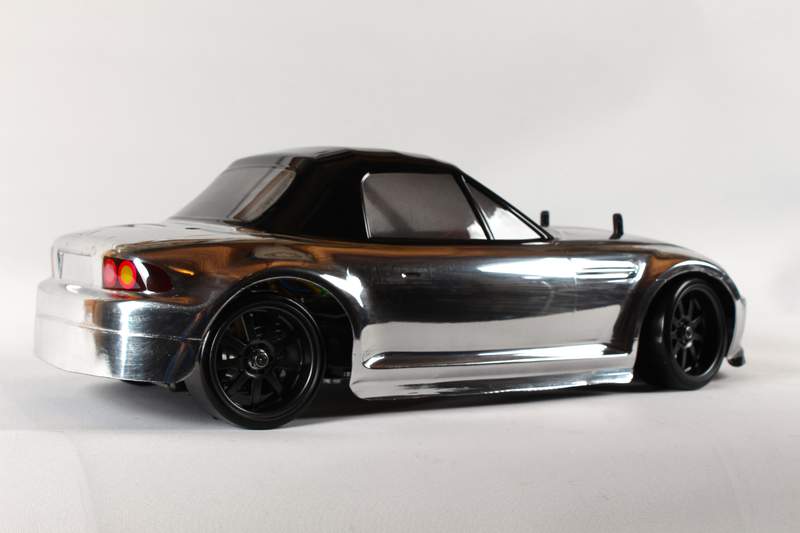

    Chrome Z3
    Body: TBG BMW Z3
    Paint: Faskolor Faspearl Black on the top and details. Satin silver and various on lights. Spazstix Mirror Chrome on body.
    Method: Airbrush
    Masking: Fasmask and handcut windows and details on front. Home made mask for head/taillights.
    Stickers: None
    Finally a full chrome body. Used two thin coats of chrome backed by black. Then, to secure the paint even better, I added a good blob of Hudyfix to keep the paint form cracking. It's already tested to work just fine. The trouble was rather the body rubbing on shock towers....
    Hint: Don't cut this body on the lines for the wheel wells if using for M-chassis with small wheels. Pictures are with 1/10 touring/drift wheels.

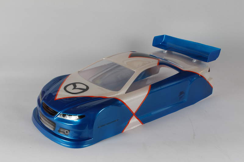

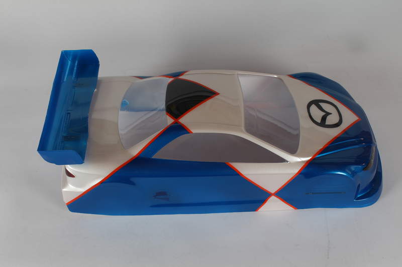

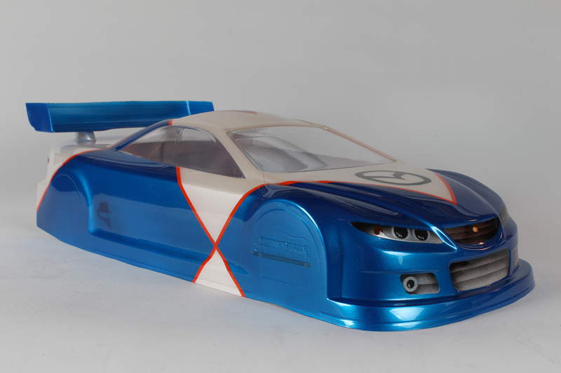

            Diamond Speed6
            Body: Protoform Mazda Speed 6
            Paint: Faskolor: Faspearl White and Blue, Fasorange, Mixed Black for Flying M and roof, Silver, Black, Reds and Orange for the lights
            Method: Airbrush
            Masking: "Homemade" machine-cut and Fasmask
            Stickers: None
            If it looks familiar, it is because it is a version of the body on the Protoform catalogue

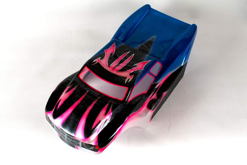

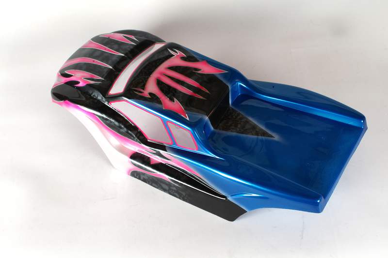

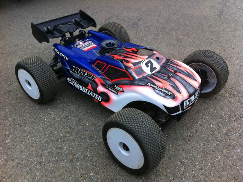

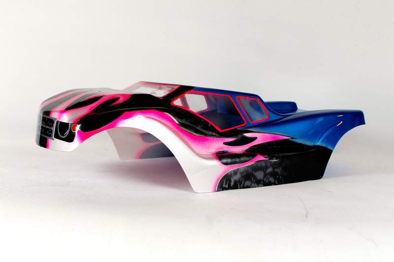

                Maifield RC8T inspired
                Body: JConcepts RC8T Truggy Body
                Paint: Faskolor White, Charcoal Black, Silver Faspearl Blue, orange. Spazstix Mirror Chrome.
                Method: Airbrush
                Masking: Fasmask and handout as well as vinyl home cut masks for tribal flames. Transparency (Overhead) film for handheld scull mask (silver on black)
                Stickers: None
                En kompis bygger en RC8T som han lette etter karosseri til. Han kom over dette, og likte det, så da var det bare å sette igang.
                Her er min versjon:

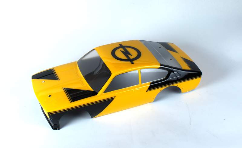

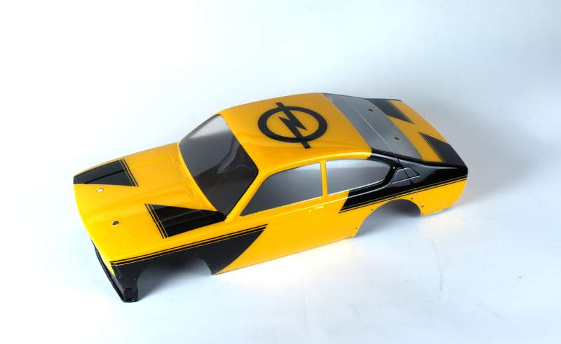

                  Opel Kadett
                  Body: Racers Paradise Opel Kadett C
                  Paint: Tamiya Yellow og Black
                  Method: Rattlecan
                  Masking: Custom homemade vinyl
                  Stickers: None
                  Denne var det litt pirkarbeid med. Vansklig å få maskeringa til å sitte rundt hjørnene, men det gikk da greit til slutt. Den har skjermbreddere som er gule bak og svarte foran. Legger til et bilde om jeg finner det. Bilen ble bra kul til slutt.

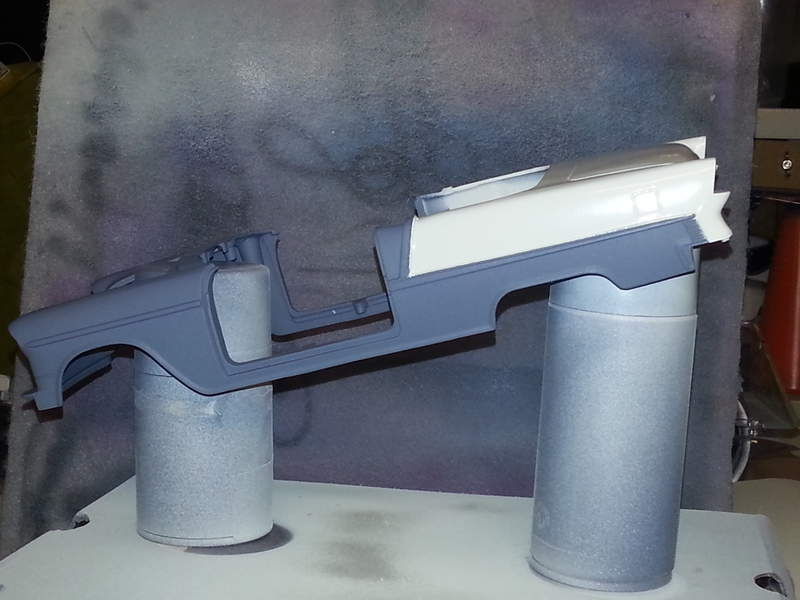

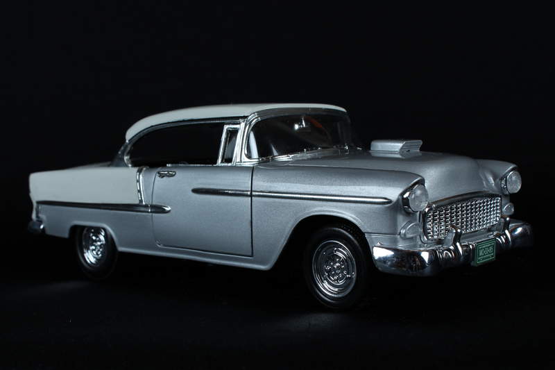

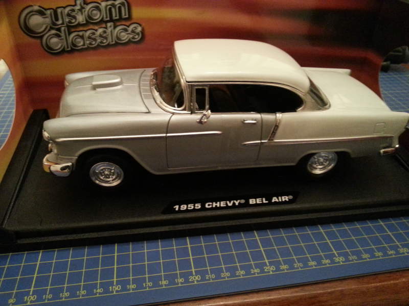

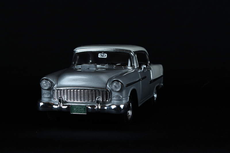

                      Diecast 1955 Chevrolet Belair
                      Body: Diecast Motormax custom classics 1955 Chevrolet Belair
                      Paint: Biltema, Primer, Offwhite and Silver Metallic, Clear
                      Method: Rattlecan
                      Masking: Fasmask

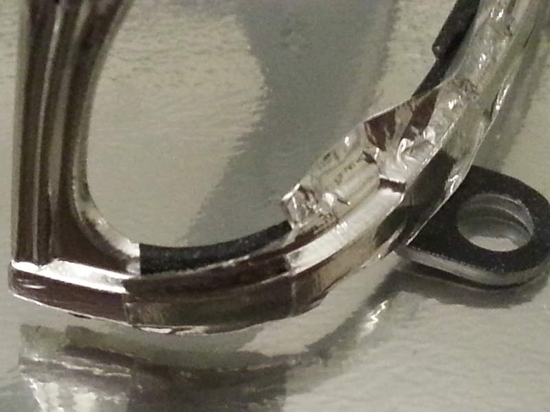

                      Stickers: Bare Metal Foil Chrome foil for all trim
                      Her fikk jeg en utfordring må jeg si. En slektning ville ha en gave som skkulle være en kopi av en bil som bygges i 1:1. Hun fant ikke bilen i sølv/hvit, og dermed hadde jeg en jobb til. Dette var nybrutt mark for meg, så da ble det endel youtube og google før løsningene var i mål.
                      Bilen måtte demonteres, noe som viste seg å gå relativt greit. Det var mye smeltede plastpins på innsiden av karosseriet som ble lett knekt/trekt ut, og som fint kunne limes på igjen med epoxy. Så måtte karosseriet strippes for svart lakk. Det var værre. Men jeg fant noe "gugge" som gjorde jobben for meg over natten, så da var det bare å gjøre rent og starte fra bunnen av med å få på farge igjen.
                      Så, når ting skulle sammen igjen, så måtte jeg finne en løsning for chromen på bilen. Det var desverre mye som skulle bli blankt som ikke var blankt i utgangspunktet på modellen. Så da ble løsningen Bare-Metal-Foil (som i bart metall) og det funka som smør. Mye pirk der også, med tannpirkere og q-tips, men resultatet ble 85%.
                      Taket var en løs del i plast, og det var rett og slett noe dritt. Særlig når to flater i forskjellige materialer skal ha samme finish. Men det ble da sånn nogenlunde det også.
                      Oh by the way, Biltemas klarlakk tåler ikke blåsprit. Ihvertfall ikke den jeg kjøpte. Urgh.. Ekstraarbeid...
                      Og her er resultatet:
