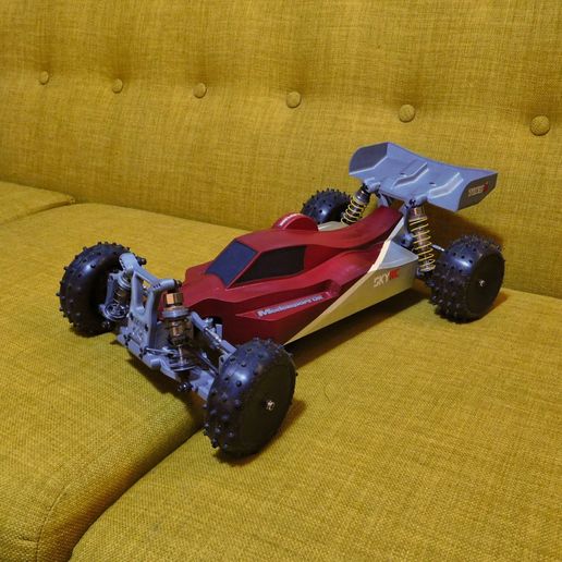

    Jeg ble akkurat ferdig med den nye bilen jeg har holdt på å designe i noen uker. Jeg har kalt den MKUltra:
    This is the Mk Ultra. A high performance belt driven 4WD 1/10 scale buggy. It is very sophisticated and capable. The car can withstand plenty of abuse, and is easy to repair and maintain. You can ask questions and read about the car development here: https://www.rcgroups.com/forums/showthread.php?2952626-MKUltra-A-3D-Printable-4WD-1-10-scale-buggy Here's a good source of hardware like bearings and fasteners for the car in one place: https://rcprinter.com/products/mkultra-build-kits Here's a great video by Elias F showing how he assembled his MK Ultra and even adapted some of his hardware to fit: https://www.youtube.com/watch?v=5rRw8LsLaLM More videos: https://youtu.be/KmVKcAIOOPk https://www.youtube.com/watch?v=1nWqq2L4IA https://youtu.be/aaEN88hye8 https://youtu.be/YBmmWoxyvKM https://youtu.be/4D7m5fsxQ9I Driving during development: https://youtu.be/OO4_NmBveJM How to install and remove the body: https://youtu.be/kis6NHcgPJY Free option parts: https://cults3d.com/en/various/oil-shocks-for-1-10-scale-rc-cars https://cults3d.com/en/various/cooling-fan-spur-gear-option-part-for-mkultra-1-10-4wd-buggy https://cults3d.com/en/various/glueless-1-10-rc-car-wheels The prototype runs with a 13,5T brushless sensored motor. -Uses easy to find belts from Schumacher K1 buggy. -Can use CV axles from multiple brands (Kyosho, Tamiya, Schumacher, Basher, Quanum, FTX and more). -Wrap around body is held on without clips or velcro and keeps dirt out. -Super precise steering thanks to ball bearings in all hinges. -Small turning radius. -Radial shock positions ensure minimal height change with shock adjustment. -Printable high strength gear, sealed gear or ball diff option. -Supports FS Racing steel gear diff with adapters. -Printable 48dp pinion and spur gears. -Printable slipper clutch option. -Sway bar option front and rear. -Two body styles to choose from. -Many adjustment possibilities. -Designed to comply with ROAR regulations. -Easy to use shorty battery mount without clips. Dimensions: Wheelbase: 283.3-289.3 mm (adjustable with different rear arms) Width: 249 mm (With quanum Vandal front CVD's and zero camber) Front and rear track: Adjustable with different hexes. Final drive gear ratio: 2.125:1 with 16t layshaft. 2:1 with 17t layshaft Chassis length: 358.5 mm Assembly notes: -Option parts to use FS racing steel gear diff (Part 511687) can be made, though they aren't needed in my opinion, as the printable gear diff has not caused problems for me at all. The pulley part replaces the outside bevel gear on the FS diff and the spacers are used inside the 12x18x4 bearings on each side of the diff. This diff works with CVD shafts that have
    Den har overlegen holdbarhet og kjøreegenskaper sammenlignet med den forrige jeg lagde, Lynx. Karosseriet omslutter chassis slik at det holder seg på plass uten klips eller borrelås, og holder så godt som all skit ute. Målet var en moderne konkurransebuggy. Jeg skal ikke late som at jeg har like mye peiling som ingeniørene til Associated, Xray og Schumacher, men tror ikke det finnes en bedre 3D-printbar RC-bil i dag. Jeg skal filme den når det tørker opp her igjen. Er så vått nå at det bare blir griseri.
