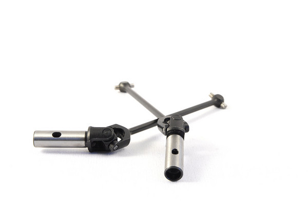

      Lurer på hvorfor ikke flere biler bruker universalaksling som Yellow. Brukes jo på nesten alt av overføring innen 1:1 og industri og er ganske skuddsikkert.

      Rasjonalen til herr JQ himself.
      I have never liked the so-called CVD's. Personally I believe they are used mostly because they are cheaper to manufacture, and because they are trendy now. In my opinion the cons clearly outweigh the pros. They wear out faster, they work differently when worn out and when new (inconsistent), they require more maintenance, they require larger bearings and bulkier hubs, unless you want to loose pins. So I went with the bulletproof universal joint. For me it was a simple choice.
