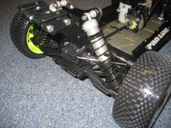

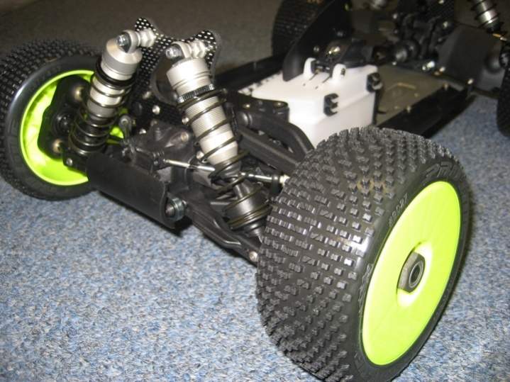

      Hei, her kommer litt test info om den nye bilen. Fra Scott Huges
      To all,
      I was able to get the 6 built and ran at the final Saturday Series yesterday. The car is amazing. I had a .5 second of a lap with several other laps faster then the Drake. My consistency was a little off but going back this morning to do some more testing and running for the worlds. I wasn't trying to do hero laps either. I was really impressed and looking forward on the worlds.
      Dette er hva han kjørte på testen:
      Shocks
      6 hole piston (not sure on hole size) try and get that before the worlds
      350 front 300 rear
      soft spring in rear
      medium spring in front
      Diffs
      7,000 frt
      10,000 center
      3,000 rear
      I went with thicker diffs due to running on a high bit, smoother track during testing
      Overall
      Car has ALL NEW parts. Off of the top of my head there is nothing interchangeable except some bearings and such. Maybe the steering rack but I'm not even sure of that.
      Legger v et par bilder han posta også!
