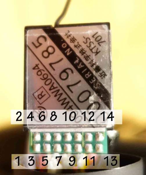

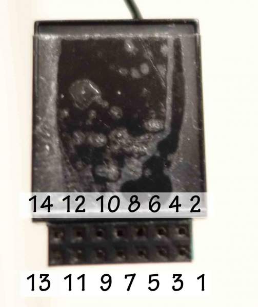

    • Her følger det jeg vet om KTSS-701 modulen jeg lovet
      Følger på engelsk da jeg også har noen andre forum/tråder som hjalp meg veldig på vei....
      KTSS-701
      Internals and common for all KTSS-701 modules:
      microcontroller: microchip PIC16F690
      rf-chip: cyrf6936
      module connector
      1 - VDD CYRF cyrf6936pin 15,33,38,40
      2 - VDD PIC
      3 - pic16f690pin19
      4 - pic16f690pin18
      5 - pic16f690pin17
      6 - pic16f690pin13
      7 - pic16f690pin5
      8 - pic16f690pin6
      9 - pic16f690pin7
      10 - pic16f690pin8
      11 - pic16f690pin12
      12 - pic16f690pin10
      13 - pic16f690pin4
      14 VSS/GND
      connections between rf-chip and microcontroller
      cyrf6936pin24 - _SS (cyrf signal name) - pic16f690pin2
      cyrf6936pin25 - SCK (cyrf signal name) - pic16f690pin3
      cyrf6936pin26 - IRQ / GPIO (cyrf signal name) - pic16f690pin14
      cyrf6936pin28 - MISO / GPIO (cyrf signal name) - pic16f690pin15
      pinout PIC16F690 (not mentioned above)
      1 - VDD
      9 - RC7 - not sure
      11 - RB6 - not sure
      16 - RC0 - not sure
      20 - VSS/GND
      Pinout for KTSS-701 in KT-18 transmitter
      module connector
      1 - VDD Cyrf +3V0
      2 - VDD PIC +3V0
      3 - throttle trim up / pairing (active low)
      4 - throttle trim down / reset (active low)
      5 - not sure, but 4.6V high when KTSS-701 not mounted on KT-18 motherboard and 3.6V when connected.
      6 - steering trim, no key pressed 0V, R trim pressed 1V5, L trim pressed 2V5
      7 - beeper output
      8 - led ouput
      9 - throttle potmeter, center 1V5, Full throttle 0V8, Full brake 2V17
      10 - steering potmeter, center 1V5, Full Left 0V16, Full Right 2V96
      11 - not sure
      12 - not sure
      13 - not sure, 0V when KTSS-701 not mounted on the KT-18 motherboard and 3V when module connected. Seems to be an output from the KTSS-701 module
      14 - VSS/GND
      For KTSS-701 in RF-902SM module
      module connector
      1 - VDD Cyrf +3V3
      2 - VDD PIC +3V3
      3 - 3V3
      4 - 3V3
      5 - 3V3
      6 - 3V3
      7 - 0V
      8 - led output
      9 - 0V
      10 - 0V
      11 - signal in (datapackets)
      12 - not sure, but seems to be a sync-signal from the module
      13 - not sure, 0V when KTSS-701 not mounted on the RF-902SM motherboard and 3V when module connected. Seems to be an output from the KTSS-701 module
      14 - VSS/GND
      For RF-901SM modulen har jeg kikket mest på protokollen mellom KTSS-701 modulen og mikrokontrolleren på RF-901SM modulens hovekort. Jeg hadde ikke bra nok verktøy til å gjøre dette ordentlig, så de resultatene ser jeg ingen grunn ti lå publisere.
      Vedlagt er bidler som viser pin-layout på KTSS-701 modulen.
